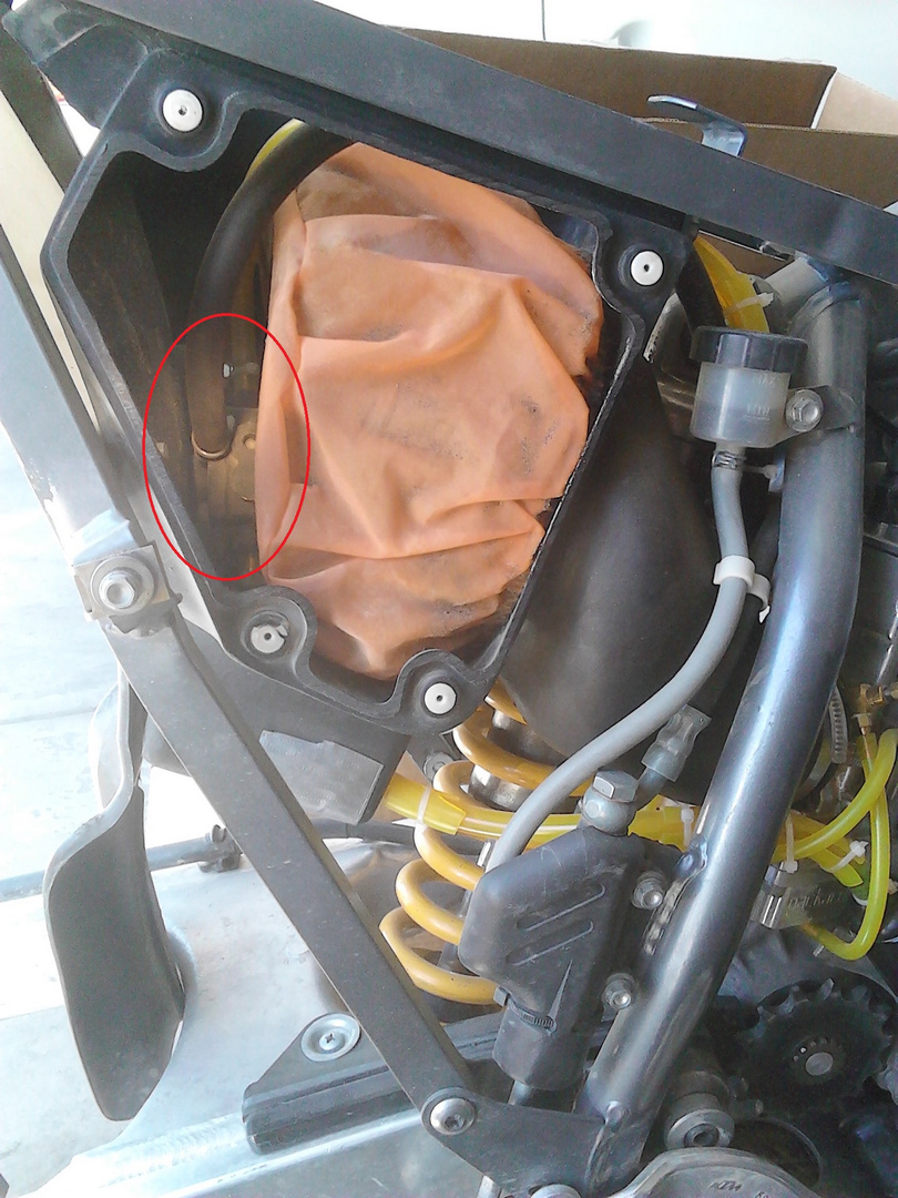

not sure it matters much where the pump is located. i had concearns it needed to be below the fuel level but turns out that isnt true. had mine above fuel level and worked great. had the black mikuni. never tried any of the other ones

Thanks for the help. I think that's the pump Im going to run as well, Dave posted a pic of it on your alky tread a while back so that's the one I ordered. Can you post some pics of how u mounted yours. I'm a Rookie when it comes to big motors, fuel pumps and alky.

im sure youll have many more options for a mounting location than i did.  back wall of the airbox is what i ended up doing and really i didnt have much other choice but it worked fine so i have no complaints . black pumps you can get from packard if need be. he also has tygon hose or you can get it from mcmaster. most my hose i got from mcmaster. seems like i was using 3/8 for the tank vent and the main line going from the pingle to the pump then 5/16 or somethin like that for the 2 lines out of the pump to the carb and 1/8 for powerjet lines

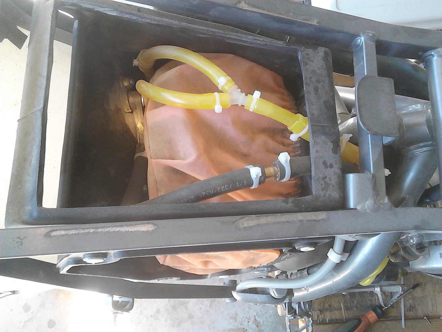

top view how i routed both lines into 1 then down to the carb. alot of what i did was trial and error as im sure youll find out also. the reason i have a extra piece of hose around the main hose is because the tygon doesnt seem to have good abrasion qaulities and i was having problems with vibration making the hose rub against stuff and it was sawing through the hose so i put a small piece of hose around the main hose in a few spots to protect it. the brass splice is simply so i can disconnect the pulse line there and remove the pump without having to pull the full length of line out, i can also disconect the fuel line at the Y so the pump can be removed rather easily. most likely you wont encounter any of these obstacles however

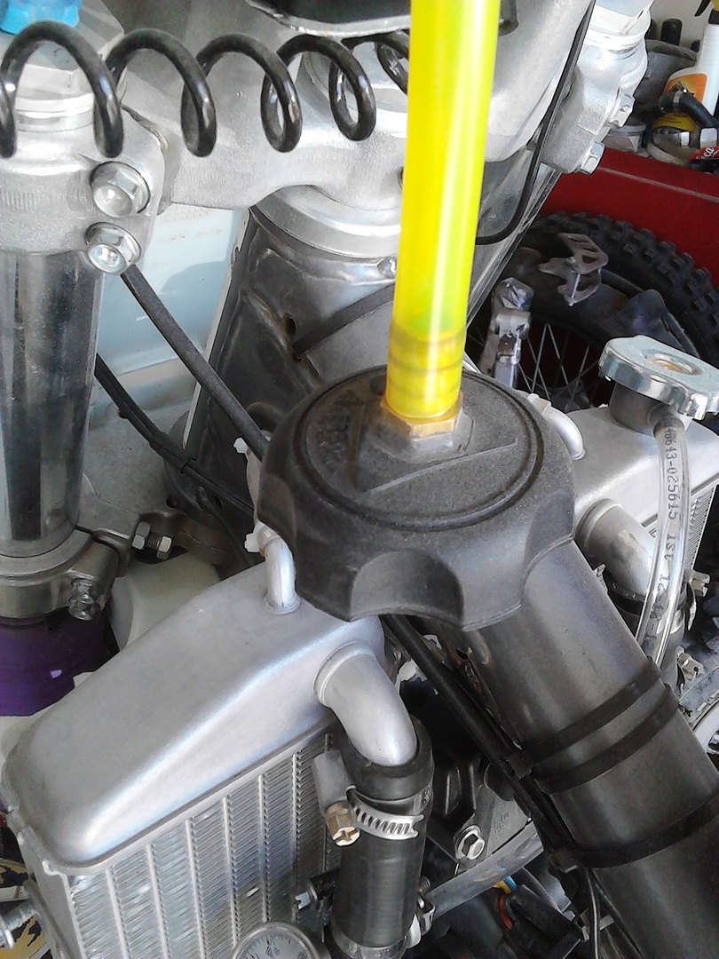

dilled out the stock gas cap and used a brass connector from the harware store. seems like it was 3/8 pipe thread on one end and a nipple on the other

I didn't mount my pump to anything.  I used fuel injection hose for the lines and they're stiff enough to hold the pump up by itself. I might have a few pics if you need any.
