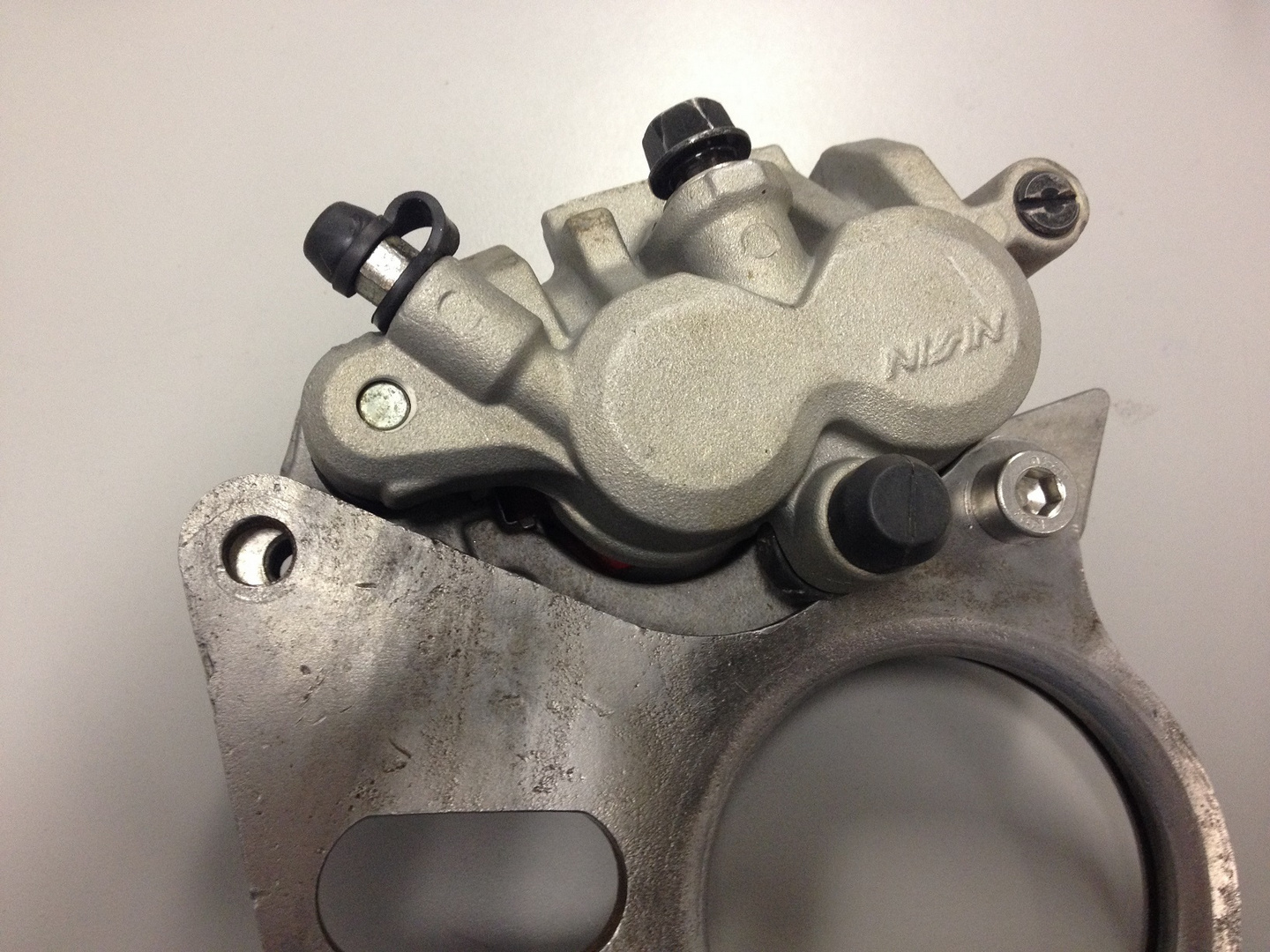

« Reply #9 on: March 23, 2015, 12:20:20 PM »
Here's a pic showing how far you have to oblong the front hole to get the CRF Caliper to attach to the 250R Bracket.

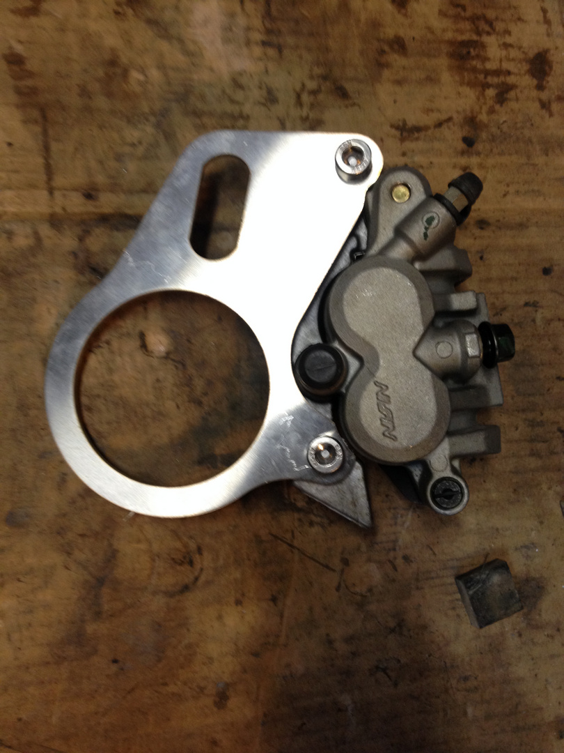

« Reply #10 on: March 23, 2015, 12:22:43 PM »
Here's a pic of the CUSTOM one I had laser cut out of 10ga Stainless Steel.

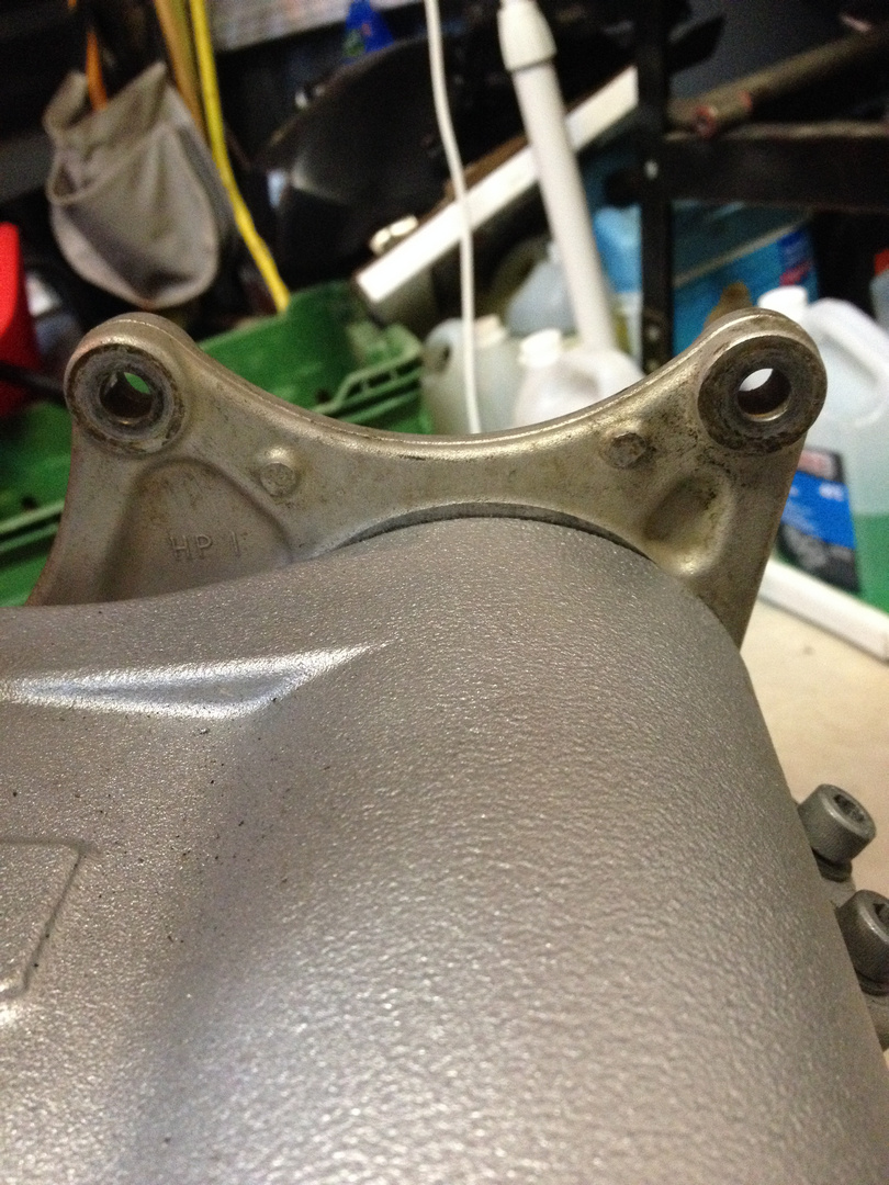

« Reply #11 on: March 23, 2015, 12:24:29 PM »
The TRX450R bracket has the correct Center to Center distance......but it's too close to the Swingarm for the Caliper to attach.... :(
