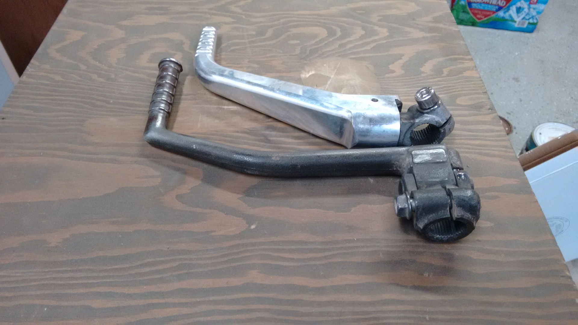

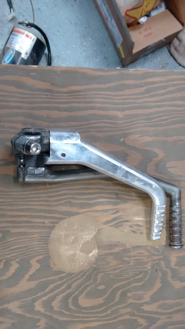

350x kicker is longer.

Depending on the exhaust you  have would ya have clearance issues ? With your toes or the kicker ?

Unsure on interference. Compared to ESR.

i know on my trx5b a longer kicker would most likely not work. the kicker is close and as it is my toe hits the pipe. i would also like to look into a compression release. does the extra hole in the head affect the dome aspects at all? depending on the depth of the release into the hole wouldnt that affect the cc size of the dome?
