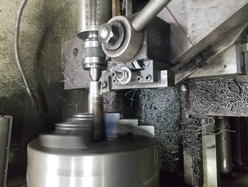

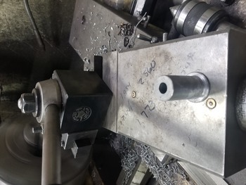

Step 2:
Machine threaded spacer. The id of the tube that the sleeves go into is .785" so the threaded sleeve is .785" od with m16x1.5  threads.

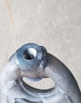

Step 3:
Tap the threaded sleeve in to the A-Arm tube
Step 4:
Weld the sleeves in.
