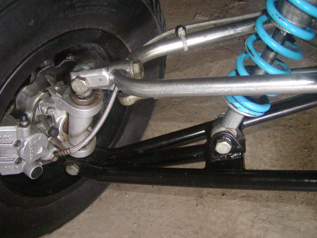

Here's an Exploded View of the Laeger T-pin. You MUST remove the Grease Zerk fitting and remove the Spring Pin that secures the two shafts together. Once removed you can unscrew them and dissassemble completely.
Part Numbers are attached for easy replacement.
Enjoy!
Special Thanks to: Croat1,Higgy87TRX425 & c41xracer - for helping me put this together.

If you have one like this....It's a LONE STAR...not LAEGER
